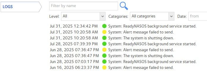

I have checked the logs and it says something like "Background process has started" as the first entry when it has started but I dont know if that is the cause.. of just a consequence of starting up.

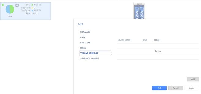

    I do have a maintenance schedule set up in the volume settings wheel, so it is possible the NAS is waking up to do the maintenance.  Or it might be a bug.
    Did you check for a maintenance schedule (easily overlooked).

      Dont think I do, but just checked.. and no... no scheduled tasks..
      While I had it started.. here are logs (I noticed it today.. but guess it turned itself on on the 28th Jul.. exactly a month after I shut it down last.. to within minutes....may be a clue?)
