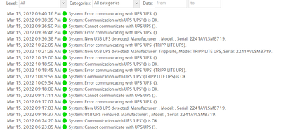

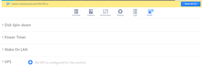

I'm having an issue where my RN104 will not stay connected to the UPS. It will show up on the front screen of the RN104 and in the admin page for a few moments when I plug in the UPS by a USB cord, but when I look at the UPS settings and close out or when the power page refreshes, I will get an "error communicating with UP" and "cannot communicate with UPS" warnings and the UPS disapears from the UPS configuration.

    • Tammorat's avatar
      Tammorat
      I have tried 2 different cables to the Staco but not to the Tripplite. the Tripplite is 25' away and I only have one cable that can reach it. the cable to the tripplite is brand new just for this. As to the USB ports I know I have tried a variation of using all three but I cant say with 100% certainty that I have tried to used each cable in each port to each USB.
      Firmware is 6.10.7
      • Tammorat's avatar
        Tammorat
        I have tried moving the cable to each of the usb ports on the RN104 but have seen no improvement in the stability of the communication between the RN104 and the TrippLite.
