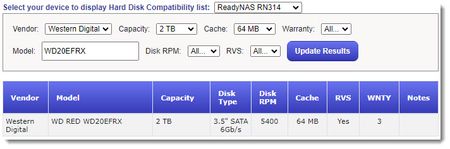

RN314 HDD Failure, now running Degraded - Need some advice which HDD to purchase
Hello Community I have a RN314 that is running well and meeting my needs. Overnight one of the HDD failed. The logs shows the following messages 03 Jul 2024 07:37:56 AM Volume: Volume ...

Step one is to get that bad drive out of the system so it doesn't keep trying to re-sync the volume. Even if it were to eventually succeed, you shouldn't trust that drive. Those re-sync tries are putting stress on all your drives.
Step two is to make sure your backup is up to date.
Step three is to completely ignore the compatibility list. It's woefully out of date. StephenB and I both recommend WD Red Plus or Red Pro or Seagate Ironwolf NAS-purposed drives. Do not get a WD Red (non-plus, non-Pro), as they use SMR recording and WD is doing customers no favor when they say they are suitable for a NAS (they are certainly not suitable if that NAS uses RAID). If you choose to look at other models, also insure that they use CMR, not SMR. Many smaller drives do use SMR.
Yes, you'll need a second drive of a larger size to get a size increase. But that's no reason not to get a larger drive as a single replacement if the space you have is currently enough. Once you need more, you'll be able to just swap out a second one. With today's prices, getting another 2TB just doesn't make sense, IMHO.
While the NAS will warn you about mixing drive speeds, it's not a real problem for desktop models. The NAS won't care about cache size at all. But be aware that a larger cache is often a sign it is an SMR drive.
Depending in part on the age of the existing drives, you may want to just start over with two much larger drives. You've had one fail, so if the others are of the same age, they could fail soon as well. Two 6TB drives will give you the same storage you currently have, though I'd probably go with at least 8TB. When you add a drive, the NAS has to re-sync it, which puts a higher stress on the other drives. A second drive failure during sync can kill your volume. You'll need to back up and restore your data, of course, but hopefully you already have a backup plan. And once you have a two-drive system, you just add another (same size or larger) to expand.

I agree with everything Sandshark told you.
I'd add that you should download the full log zip, and take a look at disk_info.log. That will give you some more details on overall disk health.
