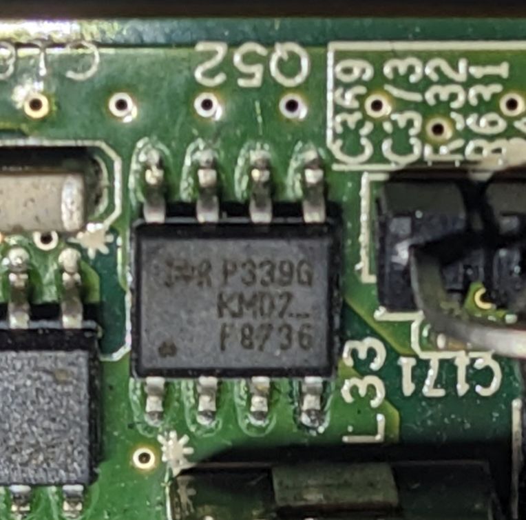

Hi all,
I need to temporarily repair my old nas to access the data as it’s died and I need to migrate to a new system.
I’ve narrowed the fault down to the component on the main board which I believe is a small mosfet ic.
It’s in the power supply section, ic Q52
Does anyone have a high res pic they can share for me so I can see the chip details. Mine is not readable.
Would be much appreciated.
Thank you.
Thank you.
Appears to be an International Rectifier IRF8736PbF.
