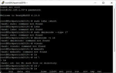

I've opened a linux shell using PuTTy with root login (as shown below), but "sudo" isn't recognized, nor is "dmidecode" nor "hwinfo". I'm guessing I need some kind of supervisor privilege to access these commands, how do I get there?

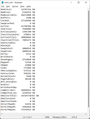

In my "meminfo" file (exported logs), seems to say I have 32GB but I don't recall installing this memory upgrade. RN528 comes with 4GB stock (so I thought).
Just want to confirm what RAM module(s) are in this thing without opening it, if possible.

    You don't need sudo, since you are logging in as root.
    You can install dmidecode if you like with
    apt-get install dmidecode
