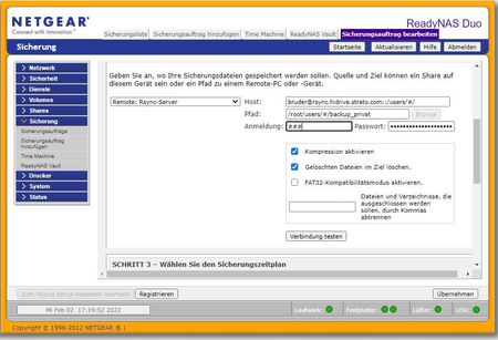

rsync ssh with ReadyNas Duo
Hello, I run for several years a backup job on my ReadyNas Duo with Strato HighDrive Cloud. Now they refuses any rsync without SSH. But where can I config the rsync ssh connection? When I use the no...
StephenB
Feb 02, 2022Guru - Experienced User
The Duo didn't support rsync over ssh for performance reasons. There was an old add-on that claimed to add it, but I think that only worked with 4.1.7 firmware. It modified the frontview html, so I think it would be pretty risky to try installing it with different firmware.
