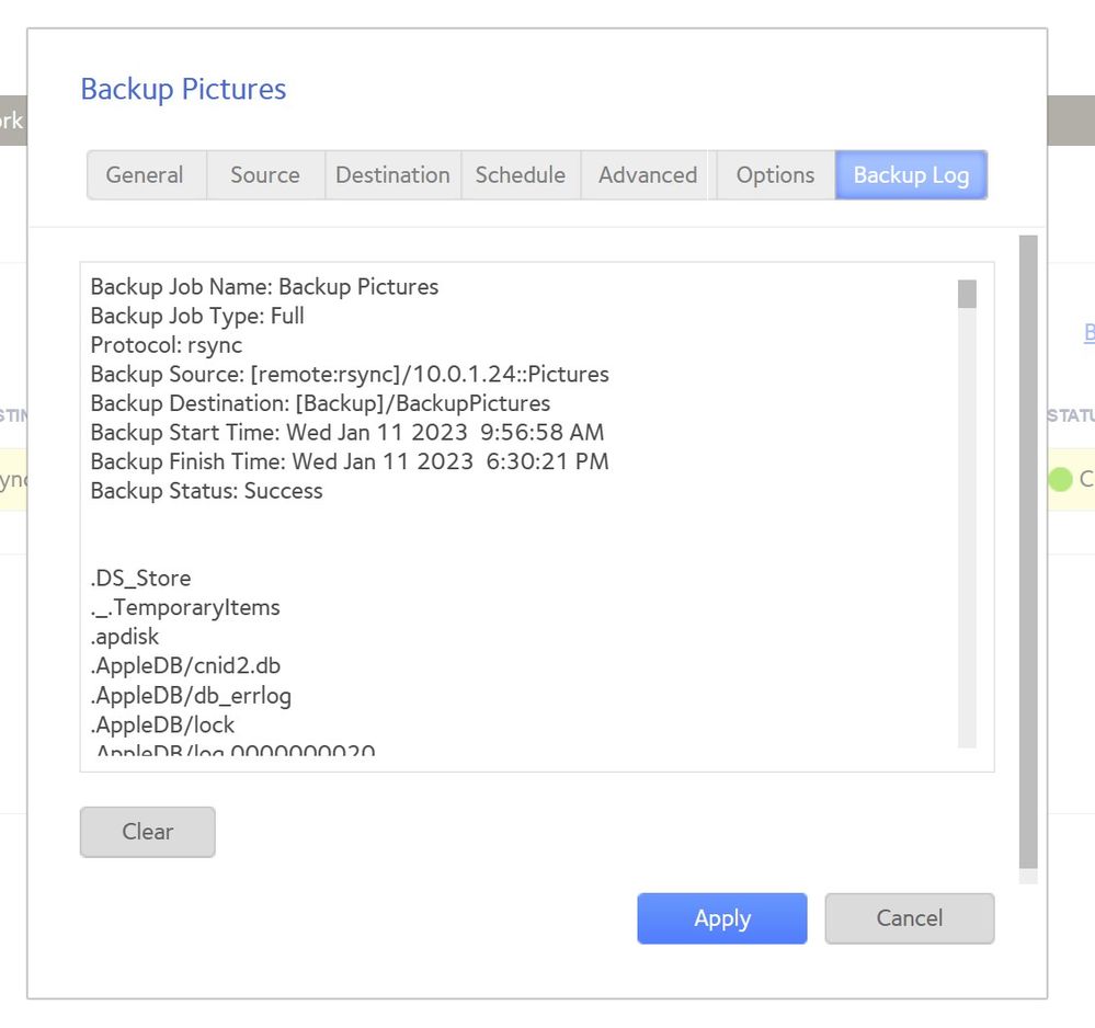

The log notes that the rsync was a success, but it is evidently not!

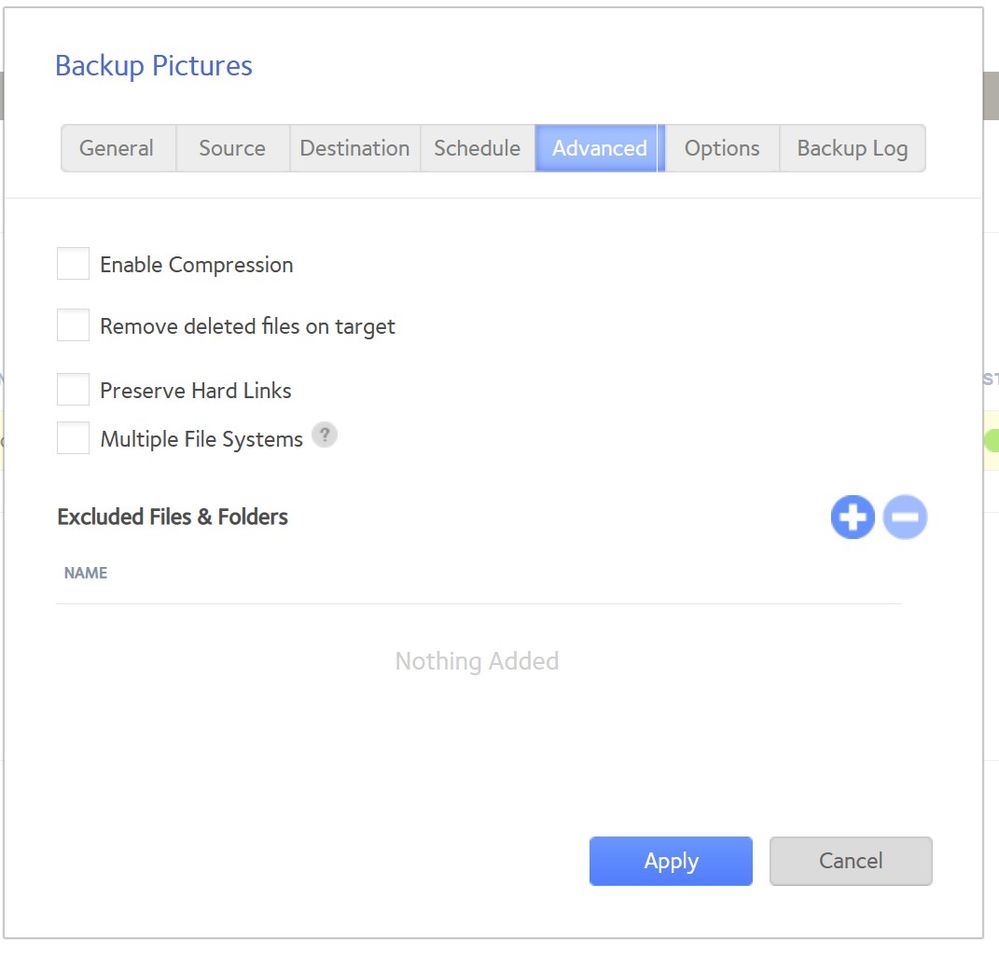

Settings:
Log of the latest job

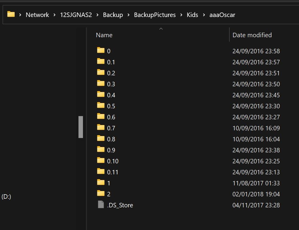

Source folder example
Destination folder example
  • But the log says it is.  I think they are being copied into Backup Pictures/Pictures because you have no trailing forward slash after the destination directory name.

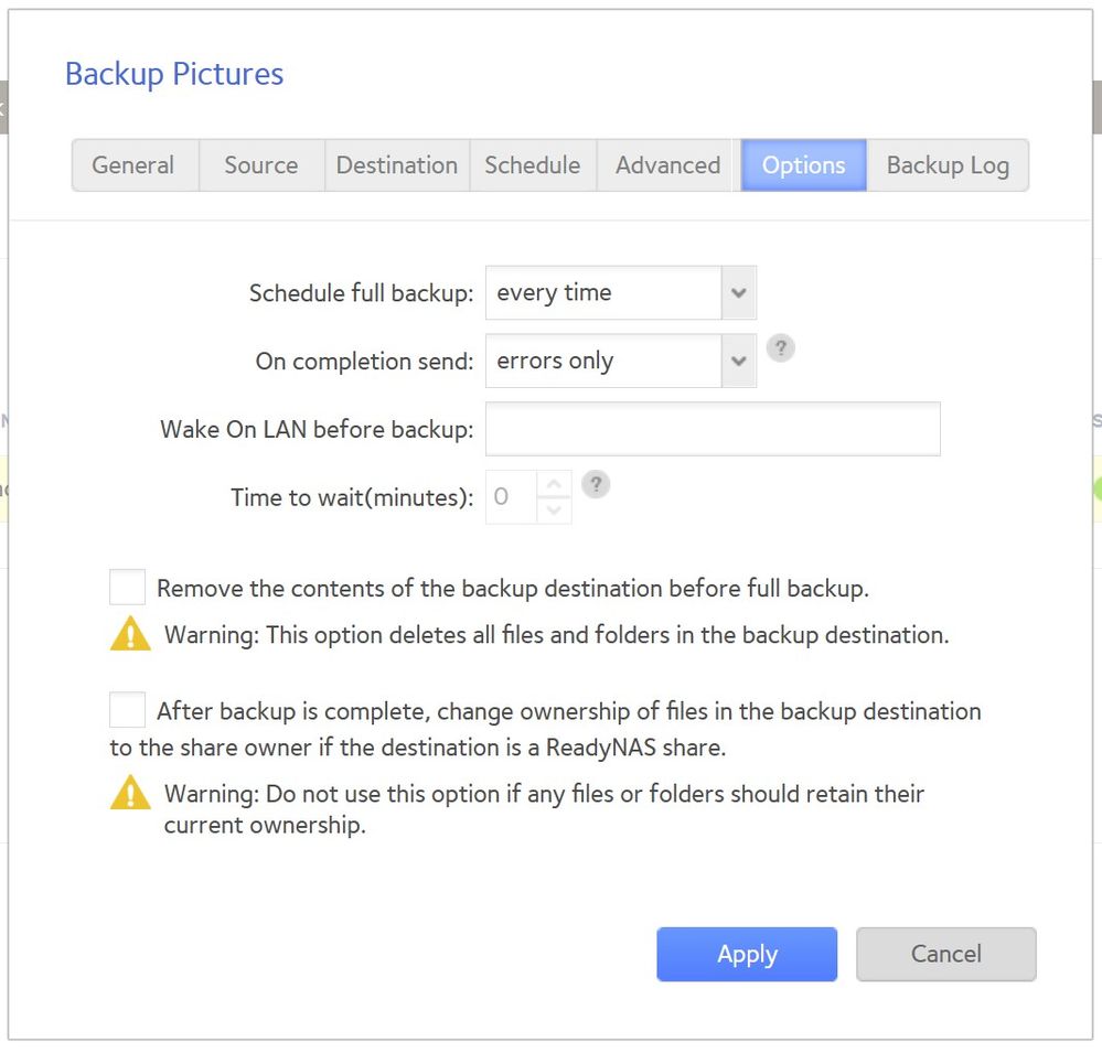

    You could try setting  "schedule full backup" on the options page back to "never" and then try again.  That won't copy over files that are already on the destination.
    • murph7355's avatar
      murph7355
      Giving this a go....but logically it doesn't make sense...? 🙂
      Shouldn't a full backup copy everything across?  And an Incremental one then only copies the things that have changed?
        incremental also copies things that are missing.
  • The Never suggestion returned a success notification, but only took 1m6secs...checked the directories and they're still not fully sync'd 😞
