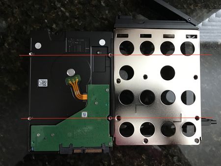

Seagate 6TB Ironwolf (ST6000VN0041) Incompatible with ReadyNAS disk trays
I took a risk and purchased 4 x 6TB Seagate Ironwolf drives, Model #ST6000VN0041 and unfortunately the mounting holes for the disks are not matched with the trays that come with the ReadyNAS 314. ...

doesn't that defeat the purpose of "toolless"? And it is not easy to remove the frame.
mdgm-ntgr
Feb 09, 2017NETGEAR Employee Retired
Well it is a workaround so that you can use these disks with the tray and the screws you already have.

There's more to say about this 3-hole issue.
You can't just remove the plastic tray. I did it, and tried for one hour to have my disks DETECTED. Yet, there were blue lights. Very misleading.
Finally, I connected one disk manually, with no trail at all. Then it worked.
So, the only right solution is to span down that sh...ty middle hole.
Netgear is doing a very poor job.
