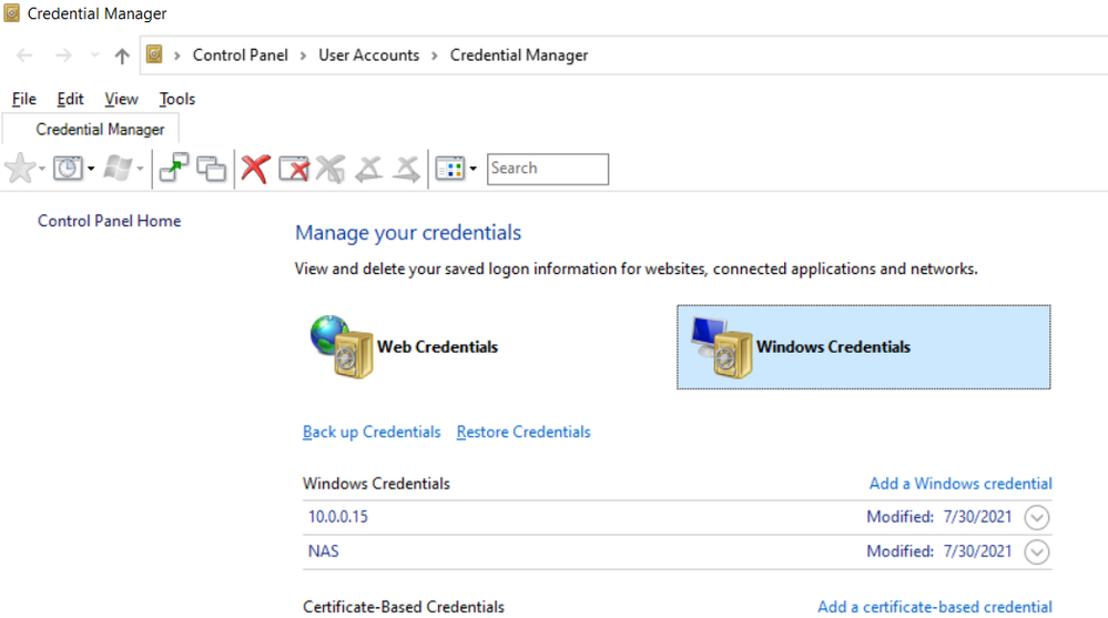

But from your symptoms, I am thinking that you should double check the Credential Manager. Make sure you are looking at Windows Credentials. Here's one from one of my PCs - the only windows credentials stored are for the NAS (one using its name, the other using its IP address).
It's worth double-checkidng the "Generic Credentials" section also, as there can be a set of credentials in there also.
