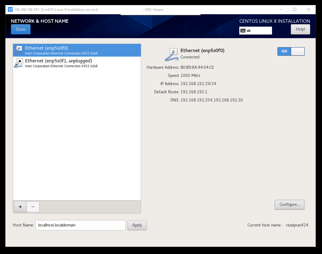

[Tutorial] How to install your own Linux OS - ReadyNAS 424
How to install your prefered Linux distro on a ReadyNAS 424.

Now we can shut down the machine we used that has the daughter board in and remove
the drive. We are also taking the flash drive.
Now we place that daughter board back into the readynas. Note the it only sits

Now we can release the pressure, if it doesn't lift back up you are good to reconnect
the ethernet cable and power. The unit will turn on and in a moment or two it will
load from the flash drive and will await your vnc viwer connection. At this point you
need to know the ip address of the readynas as the lcd display is useless at this time.
So login into to your router and find the address if you do not know the ip or have
set a dhcp entry. Example, In the vnc viewer I typed in 192.168.192.29:1 and was prompted
with a authentication prompt and entered in password and that about sums it up.
You now have a graphic installer to cleanly install the os. Do not touch the daughter
board or internal partition. You must create a /boot partition on the m.2 drive.
I used the classic partition setup
/boot = exf2|500 MiB
/swap = swap|500 MiB
/ = exf2| left the installer feild empty and it used the remaining space
