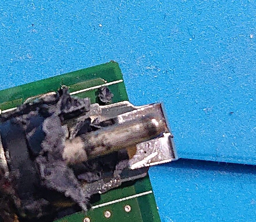

my experience:
* changing the power supply -- no difference
* opened and disassembled the chassis, cleaned everything -- no difference

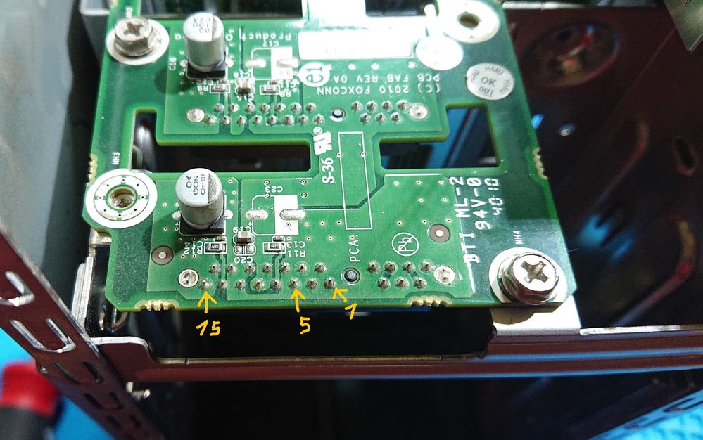

* measuring voltage on SATA backplane: <11.0V!

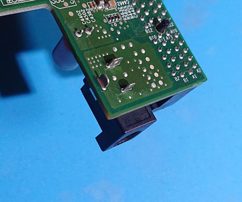

* measuring the downside pins of the power plug on the main board: <11.0V -- BINGO!
solution:
* the inner pin of the power plug was corroded/worn out. Soldered cables to the pin and a new plug outside of the chassis -- works great!

- SandsharkSensei - Experienced User
Cracked solder joints at the connector can cause a similar problem. There is usually damage to the board traces as well, so just re-soldering doesn't always help.
A wire "pigtail" is what I usually suggest. Finding the exact replacement for the connector is hard, then de-soldering and soldering takes skill and the proper equipment. A temperature-controlled soldering iron is recommended to keep from doing further damage, and getting all of the connections free simultaneously isn't easy. Just a quick tack-solder of some wires is a lot easier and can be done with a more typical home low-wattage soldering iron with just a little care. Just be sure to protect the wire from chafing where it comes through the case.
