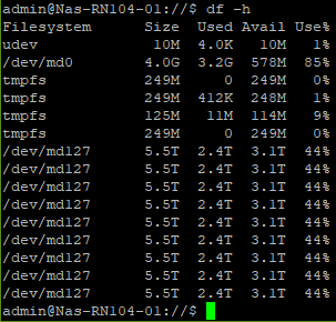

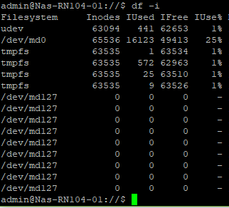

- StephenBFeb 16, 2018Guru - Experienced User
MrRipply wrote:
SMB, AFP, NFS, FTP, HTTP, HTTPS, SNMP, SSH
AntiVirus was not enabled then?
Try logging into the linux shell via ssh, and then check the current root usage.
# cd //
# df -h .
# df -i .
