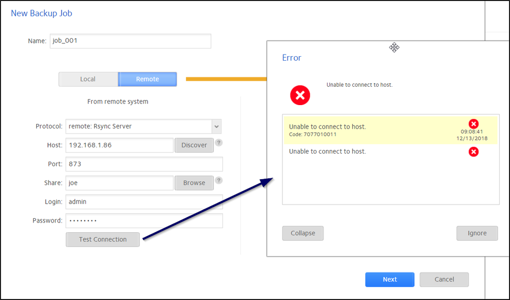

Well, it should work with just rsync.
Is the rsync protocol enabled for the remote share ("joe")?
Also, rsync is case sensitive - so if the sharename is "Joe", you need to use that in the path name.
