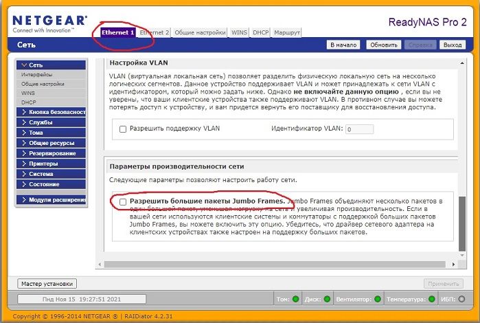

  • Try uncheck Jumbo Frames checkbox in Ethernet settings of your v2.

      Thanks for joining the discussion, RayDee. StephenB may confirm or deny, but I don't believe the Readynas Duo v2 has the ability to change the JumboFrames setting from the Web interface unlike the v1. From what I have read you have to get into the codes to alter it. It doesn't allow alteration of the MTU either which is something else I have researched. Thanks again!
