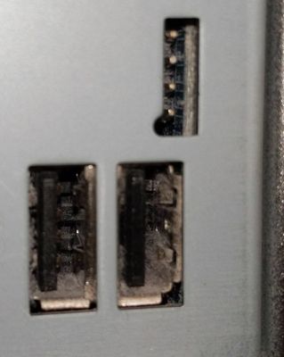

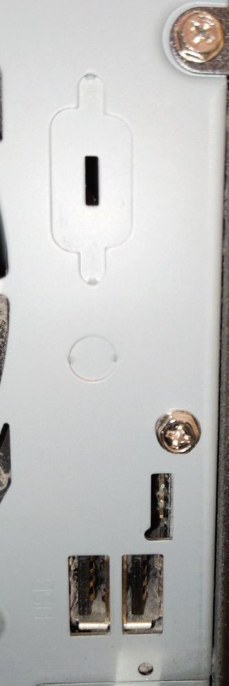

- Thanks for your thoughts, I assume that means you never tried to install a different OS? At the back I found only 2 USB ports, a 4 pin connector which I never saw before and a port which looks like a VGA port but it is blocked by a steel sheet. Do you know whether this 4 pin connector at the back is this a serial port? See picture above the two USB ports: https://www.storagereview.com/wp-content/uploads/2011/04/Netgear-ReadyNAS-Ultra-6-back1.jpg According to the guide which I stored the ReadyNAS Pro Pioneer edition RNDP600E has a VGA connector directly on the mainboard. When I look at this picture https://www.storagereview.com/wp-content/uploads/2011/04/Netgear-ReadyNAS-Ultra-6-motherboard.jpg I see several pins but nothing what looks like a VGA connector which I know from my normal PC mainboards.
Pictures of connectors.
blocked VGA(?)-port
4-pin connector
