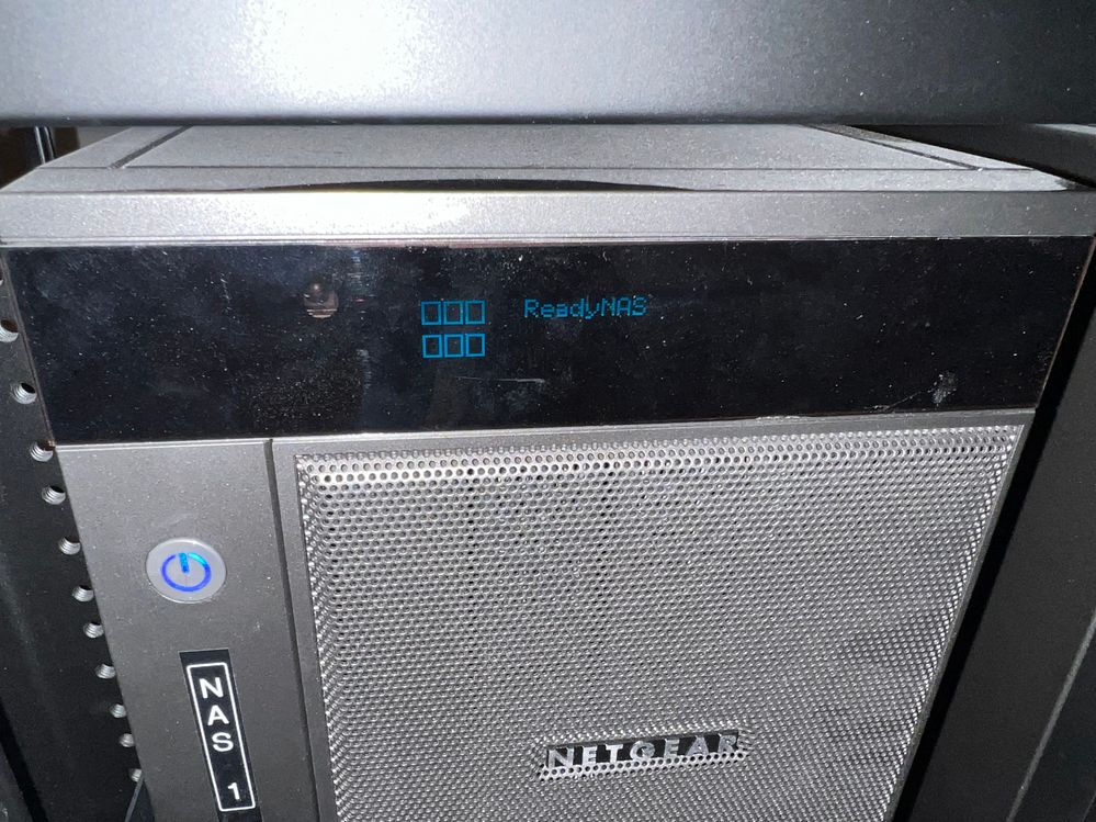

ReadyNas Ultra 6 Stuck on Boot – NOT NAS Hardware – Other Drives From Second NAS Work Fine
Let me start by saying I do not know almost anything about the recovery procedures. I am fairly technical but am not familiar with how to recover a NAS. I have browsed this forum but I have adv...

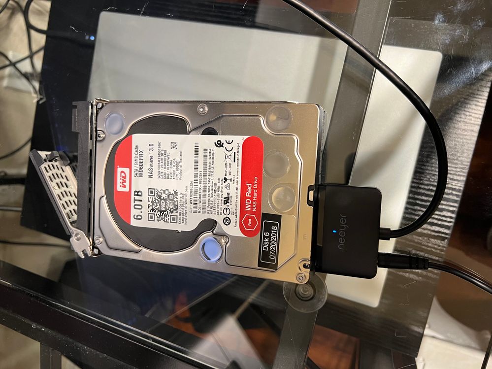

Thank you. I have exactly what you are describing. A drive adapter that powers the SATA drive and also converts the data to USB to connect to a PC.
I understand that windows will not be able to use the file system on the drive. These are WD RED drives. So I guess I need to download the “Dashboard” tool you mentioned.

Fermion wrote:
1 - What do I do once I connect the drive? What is the goal? What am I looking for?
First, run the short test on each drive. If that passes, follow it up with the long test.
The goal is just to make sure all the drives are healthy.

It is back up! This is what I did:
- I powered down the NAS1
- I removed Drive 1 from NAS1
- I powered back up NAS1
- The problem still existed
- I re-inserted Drive 1 into NAS1
- I removed Drive 2 from NAS1
- I repeated each of the above steps for ALL 6 drives
- Finally on the very last drive, Drive 6, NAS1 came up!!!!

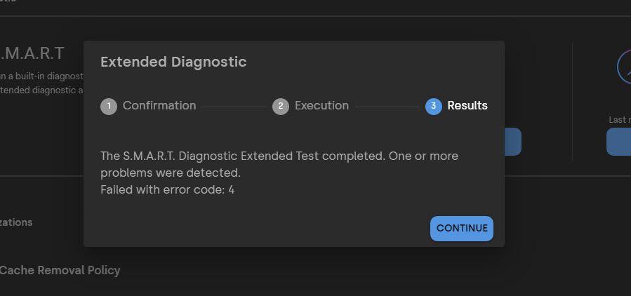

- FermionFeb 04, 2025Tutor
I have tested my drive 6 with the WD Dashboard and it is giving a SMART error:
"Failed with error code: 4"
I have ordered a new 6 TB WD Red drive to replace this failed Drive 6. I assume I can just hot install the new drive once it arrives and all my data on the NAS has been backed up? I do not plan to ever power down the NAS if I can avoid it.- StephenBFeb 04, 2025Guru - Experienced User
