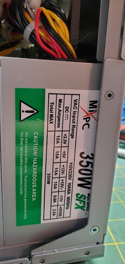

- exibarMay 29, 2022Aspirant
so this is what's in it now, a 350. I could only find my old 20pin PSU tester, but that one shows no power on the -5 output. Once I find my 24pin PSU tester I'll be able to fully test it. Not sure if -5 is on the additional 4 pins on the PSU or not.
