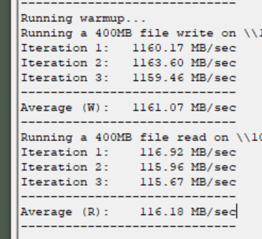

Here are the results with iperf:

iperf also shows 1 gigabit in the NAS->Client direction, so this appears to be network related.
Are you seeing this on multiple PCs?
Perhaps try different cables.

- mtarauFeb 07, 2021Aspirant
Reads from the nas are limited to 100 mb on all other PCs. The nas is connected to the 10 gb switch with both it's ports as well as to a 1 gb switch with it's other 4 normal port in LACP port. I tried changing the cables and there was no change.
