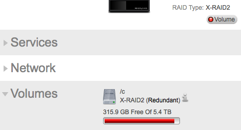

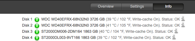

Hi, hope someone can advice.
I am running to the limit of the HD capacity and decided to replace 2 of the current installed disks with 2 higher capacity disks. Followed advise given to me in a previous post to purchase the WD Red 4TB Disks to keep it within the limits of the Readynas nv+ v2 accepted capacity.
I replace the 2TB disk in the first slot with the 4TB disk and let it recync. Which was succesful. 2 Weeks after this, I replaced the second slot 2TB disk in the second slot with the 4TB disk and let it resync. This also finished succesfully, however the capacity did not increase.
Not sure why, as I was told that this should work without any issues. How to fix this issue?

new setup has 2x 2TB + 2x 4TB disks
see attached screenshots for additional information.

        Sandshark wrote:
        Your screen captures haven't been enabled by a moderator, so I can't tell from them.
        They are now, and they do show the correct size for the 4 TB drives - so I concluded it was a v2 earlier. Also, if it were a v1, the volume would be dead, since the 4 TB drives would have been detected as < 1 TB, so the RAID array wouldn't have resynced at all.
