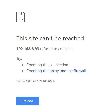

I've dug my old ReadyNas Duo V1 out as need the storage space.
Everything looks ok, lights, Raidar etc, but I can't connect to the admin page or see on my network.
Before I attempt a factory...
- Sep 03, 2018
You may want to try OS Reinstall first to reset the Network settings or doing a reboot.
If this is an old setup, if you can download the logs it would be worth checking,.
Doing a Factory reset if you have backup of your data would be the fastest route.
Regards
Compact101
Sep 03, 2018Aspirant
Thanks for the quick reply
- The PC accessing it is on the same subnet
- Yes I've tried to connect with another laptop
- Data, I could loose it, if required
I thought I'd try to access as Raidar was looking positive and any reset might be a set backwards.
Will go for the full reset and see what happens.
Thanks
