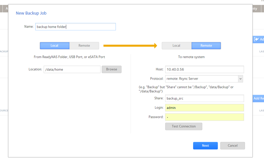

crazy_toy
Aug 02, 2017NETGEAR Expert
NAS A and NAS B
if you want to back up home folders on NAS A to B , you can create backup job on NAS A , then remote is NAS B , like below screenshot
