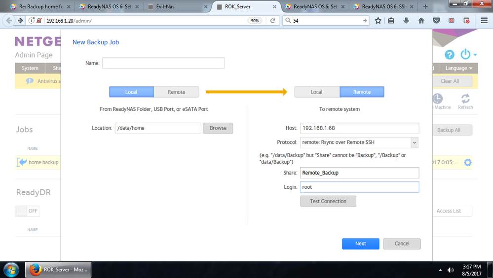

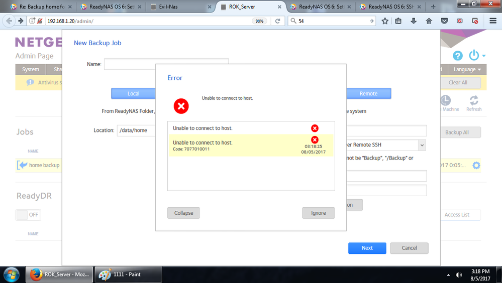

i cant get the ssh part to work
i did what thay said to do to the "T"
and i get a error.. i am using all internal ip's so i dont know if thats whats wrong
both readynas are both on the same network ATM
not sure what realy to do with the "key" A text file will be downloaded with the public key. Generally, this goes in ~/.ssh/authorized_keys of your destination
i tryed to place it in the admin ssh folder. tryed to coppy past the Key in to the text file in that folder by default.. not sure what to do i know what it is just not where it goes

i did the host user on both and swaped keys as you tell me to do and still nothing,
i am using the moth on INT ips so exp:192.168.1.10 for Nas A and 192.168.1.20 for Nas B
not sure if i nead to open the port 22 when i get it working on Int IP and more it over to
EXT IP ( over the internet)
so my questions atm is when setting up ssh backup i put that host user account as the login and it doesent ask for a password for some reason?? (odd) and dont use admin or root account (Right?) and did you see and thing else i did wrong on any other part of the setup? such as the shair ? its a shair strait off the main root Data/(share name)
Again, getting the backup(s) working on the local lan will flush out any mistakes in the backup job settings. In general, you will need rsync enabled for the destination share(s) on NAS B.
