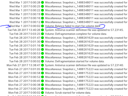

Balance failed to start for volume data
This morning, my email notification reported the following error: "Volume: Balance failed to start for volume data." I searched for this message on the community forum, and the documentation,...

Mar 02, 2017From your screenshot I see, that you have Antivirus service enabled as it is updating the virus definitions. In 6.6.1. AV seems to be a bit unreliable and the potential cause of various issues.
I would disable that service and manually run balance a few minutes after that. If that goes through fine, there is a good chance, that your scheduled balance will also run fine the next time it should kick off anyways.
- AndrewJohnMar 02, 2017Aspirant
Thank you Roland,
I will try that tonight, or in the morning.
I've read about the unreliableness..., but I am more likely to error on over-protection, than turning it off permanently.
But, for a couple manual rebalances, will do.
thank you,
AJ
