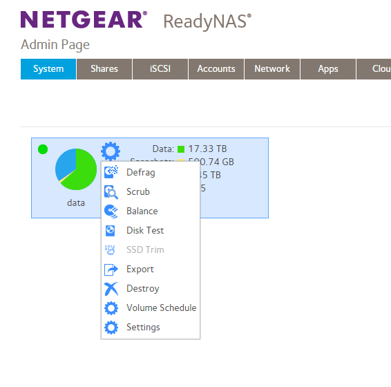

Might be worth running a balance and a scrub from the volume settings wheel.

I am running Netgear ReadyNAS 314 version 6.10.10 and I don't have such maintenance options available on the Volume.
