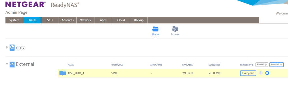

Here's some stuff to check. When you go to the shares page of the NAS admin UI (not the "Browse" page), you should see something like this:

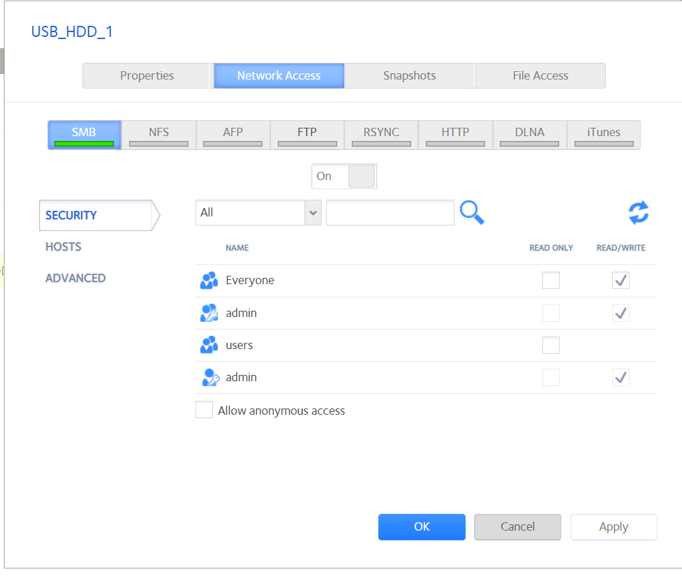

Click on the settings wheel on the right, and then choose "settings" and "Network access". You should then see this screen:
Make sure SMB is enabled (with a green stripe). Also make sure that both your ReadyNAS account and admin have read/write access. (the settings above will do that, but note they give everyone read/write access).
