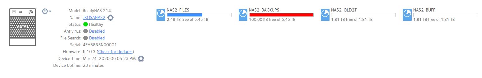

I am having a similar problem some older threads (links to them below)... files deleted from a volume do not free up space.
4 JBOD drives, various sizes, using this as a basic file server
Firmware - 6.10.3 - just updated today, skipped several previous firmware updates (didn't know they were avail)
Snapshots - Never enabled
Received email warning a few times over past 6mo warning that disk space was running low, 30% remaining, then 20% remaining, etc.   Each time, we deleted old EASEUS backup files that each connected PC was saving out on the NAS.  Didn't realize until today that each time we deleted it wasn't freeing up space.
Today I downloaded firmware update, then (mistakenly probably) started a Scrub but after 4hrs with no indication if it was running, I decided to reboot to let the firmware update complete.   Then ran a Balance, it quicken reported it was done.  Then tried running a DeFrag, but after some time with no report of progress I restarted based on advice from prior threads.
I saw suggestions for using ssh and will try to see if there are any hidden snapshots or something.   Would appreciate any newer advice since all of the threads I've been reading are 2+ years old.

      I downloaded the logs yesterday, so I do have those if it becomes helpful to share them.   This morning I started the Defrag again, and I will do the Scrub afterwards.   Hopefully that is the right order to do them in - I will report back when they are done.  I ran the Balance task yesterday and it finished very quickly - perhaps because it is only trying to balance the remaining space which is practically nothing.
      This is only an issue on 1 of my 4 volumes, at this time.  The volume is 6Tb & has only 1 share on it that 4-6 Windows PCs access for backups (either Norton 360 or EASUS Backup).   From Windows File Manager properties, there is less than 3Tb of files, but the NAS thinks it is at 5.45Tb with only 100K remaining.   When we first received an email warning that disk space was low (around 5mo ago), I deleted old backups, and assumed it was freeing up the space.   I have not looked at the other volumes to see if deleted files aren't releasing their space, but will run the maintenance tasks on those too.  If you suggest a different order to do the defrag, scrub, balance, I'd appreciate the input.
      I looked for the Quota setting... in one place the Quota box is checked, in another place it is unchecked.   From the System Tab >Volumes, I click the gear for this particular volume, then click Settings.  The Summary has Checksum (unchecked) and Quota (checked).   Alternatively, from the Shares Tab, I mouse over the 1 share on this volume and click the gear, then click Settings.  The window that opens has a Properties Tab with Quota at the bottom (unchecked) and no size.   Not sure yet how these 2 options differ - since I don't have different shares per person where I would be balancing/limited usage, maybe it doesn't matter in my case.
      Appreciate any input and I will report back when defrag, scrub and balance are complete.   4Js : )
