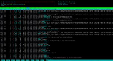

CrashPlan Performance
I've been using CrashPlan on my Pro 6 for quite some time now and have been very happy with it. All of what I want to backup (to CrashPlan's cloud) is already there, and not much additional data is g...

So you just leave the CPU% at 100%? It doesn't impact things like SMB performance if a backup is running at the same time?
I had some PC2-6400 DIMMs kicking around so I tested the unit with 2GB. It is seems to have completely resolved the issue so RAM does seem to be the culprit. I was thinking of ordering a new kit of 2 x 2GB, but now that you mention you upgraded your unit to 8GB I'm thinking that may be the way to go. Can I ask what brand/spec of RAM you're using in yours?
Also, I'm not familiar with the -Xmx setting? Can you elaborate or point me in the right direction?
I do have dedupe set to minimal and compression off.
Thanks for your reply!
