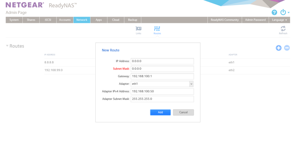

Hello there, I am trying to set a default route using statically configured eth1 interface. I am in Networks - Routes menu and I enter 0.0.0.0 for IP and 0.0.0.0 for subnet mask. Subnet mask does not accept such entry. What should I do ?

    Normally you use 255.255.255.255 as the subnet mask for IP address 0.0.0.0
    Also, you appear to have configured Google's public DNS server (8.8.8.8) as a static route - which of course won't work.
    What are you trying to accomplish?  Wouldn't it be simpler to just remove the second ethernet connection?

      StephenB - thank you for the response, I will try that. But just to be preceise, using 0.0.0.0/32 is not normal. Industry standard says:
      "The default route in Internet Protocol Version 4 (IPv4) is designated as the zero-address 0.0.0.0/0 in CIDR notation"
      I will now remove the 8.8.8.8/32 route - i was using it to test.
      I am trying to get the ReadyNAS connect to the NTP servers which are factory specified to be "time-e.netgear.com" and which would not work without DNS...which would not work without default route or local DNS server which we dont have.
      I cannot just remove second ethernet connection. This is a backup NFS appliance for several networks and so it needs to be connected to these networks.
        Yeah, it might not work - (and could give you an unrouteable error).  if you need 0.0.0.0 with a 0.0.0.0 mask, then you might need to use ssh.
        But I don't still understand the purpose for entering it.  Traffic that isn't sent to 192.168.100.x and isn't covered by another static route should be going to 192.168.100.1 anyway,. correct?
