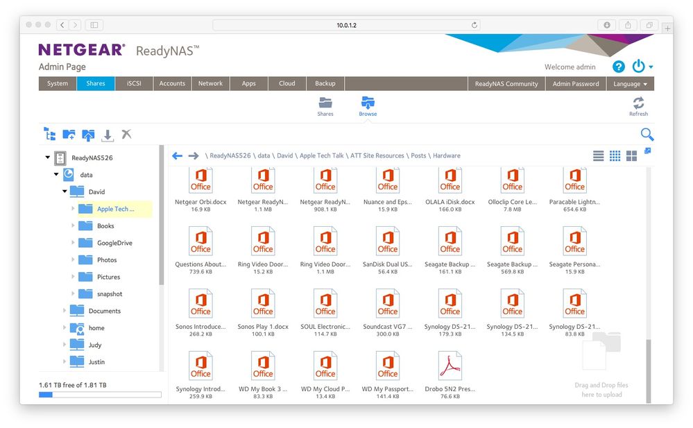

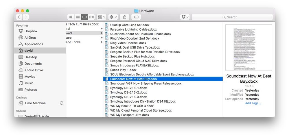

I am also attaching two screen shots.This is my current Finder Window.Notice the file Soundcast Now At Best Buy.docx. I uploaded this to Dropbox yesterday afternoon which is after I did a full resync of my Dropbox folder.Here is the corresponding folder on the ReadyNAS that Dropbox is syncing to. You wil see that the file is not there.This is not unique to this file. This has been happening on every file since I started using the Dropbox Sync. On the initial sync, everything comes over but after that, the folder on the ReadyNAS is never updated.Thanks for your help.Regards,David
