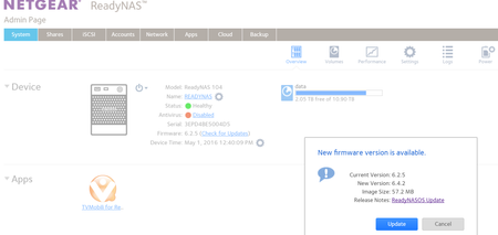

Firmware Upgrade not working
Hi all, Every time I log into my ReadyNAS Admin Page, I get this message. I press 'Update', it downloads the new firmware, and says it needs ot reboot to install. Then it boots back up to the exa...

- herbie747May 23, 2016Aspirant
So this didn't actually work in the end. I got an error when I tried to upload the complete-flash-update_1.0_armel.deb file.
Any more suggestions? Thanks.
