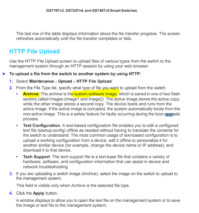

I downloaded the latest firmware for my GS724T v4, but i cannot find a way to upgrade. Due to the manual, there should be someting on Maintenance - Upload .. but it does not match the manual here. The maual tells nothing than wrong information about firmware udates. Even the help file which comes with the firmware, points to a page with wrong information.
What is the way to update the firmware?

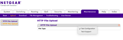

  • Ah looks like we face the old confusion from the basic mechanics in the physic course at school ... on these earlier Netgear Switch design, it's Download. Think about you sit on the switch.
    Sorry for not having realized this user mistake before.

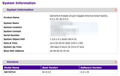

    To avoid any kind of confusion - there re about  dozen GS724T in the field for almost 30 years - what exactly is the model type, version and in case hardware release variants printed on the product label.
    Which firmware version is currently installed on the GS724T you attempt to update?
    In case there is no menu like
    Maintenance > Upload > HTTP File Upload
    ... allowing the upload of what Netgear designated an "Archive" decades ago, it's neither  GS724Tv4, nor a GS716Tv3, nor a GS748Tv5:
    Is the switch discoverable on your LAN (resp. the management VLAN) using the NETGEAR Switch Discovery Tool available for Windows, MacOS, and some Linux builds?
    The System Information page of ll these switches does certainly show lot of useful insights, including the current installed and active firmware version...

    • FriFra's avatar
      FriFra
      i cannot read the product label, since the switch is mounted and i wll not unmount for reading a label. The information in the ui should be enough.
      I downloaded 6.3.1.47 directly from the support page of my registered switch, so i expect to have the right one.
      There is no way to upload at: "Maintenance > Upload > HTTP File Upload"
