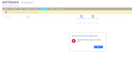

Hello, I am trying to install Milestone Arcus Surveillance on ReadyNas 314 6.10.8, but when i click on install button i have this message : Are you able to help me ?

Licenses for Arcus aren't available anymore - that ended in 12/31/2018. At that time, Netgear removed it from the app store.

Were you reinstalling for some reason?
