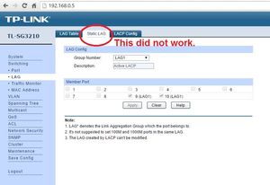

How I got Bonding to work with a TP-Link TL-SG3210 switch
Hello, I thought I would share, since I was puzzled how or why this happened to me and the switch I had. In the end, I got everything to work, and I do NOT think it is a NTGR issue, but if someo...

You definitely want LACP if you are bonding at the switch.
If you have an unmanaged switch, you can try "adaptive load balancing" on the NAS (with no configuration needed anywhere else).

The choices were Static LAG or LACP, I guess, but there is little documentation with that switch, so I had to guess.
I agree that the choices are confusing and usually under-documented. You ended up in the right place, and your post will be helpful to others.
Generally the best options with the NAS are LACP (either with a managed switch or an R8500 router), or Adaptive Load Balancing (which works with unmanaged switches). If you don't understand exactly what you are doing, you should simply ignore the other options.
Also, I'd like to point out that the gains for home users aren't very compelling. It's frankly not worth spending a lot of time getting this to work, unless you are in an enterprise environment with lots of users.
