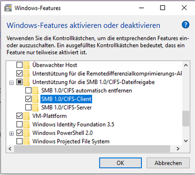

    no need to change the IP address.
    -> https://learn.microsoft.com/en-us/windows-server/storage/file-server/troubleshoot/detect-enable-and-disable-smbv1-v2-v3?tabs=server#windows-81-windows-10-and-windows-11-add-or-remove-programs-method
    On Windows 11 it's even easier:
    in long, head to the Control Panel ... locate Add and Remove Programs ... locate SMB 1.0/CIFS File Sharing ... tick the SMB 1.0/CIFS-Client in case you have Windows 7, 8, 10 and Apply ([Ok])

        To be workable with these legacy systems, SMB 1.0/CIFS has to be enabled.
        Of course, the NAS must be configured for the same IP subnet like your router and the PC. Enable the NAS DHCP in case, or configure an appropriate free IP address, correct subnet default gateway (the router LAN IP), and point the NAS for this DNS server address, too.
