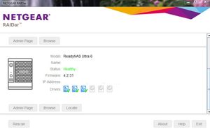

How to upgrade from OS 4.2.31 to OS 6 on a Readynas Ultra 6
Can anyone provide me with the steps to upgrade from OS 4.2.31 to OS 6 on a Readynas Ultra 6. And do I have to update the BIOS as well before the upgrade? Thanks.

thekidbass
Dec 30, 2022Tutor
Well, I since didn't get a response in time, I went head and updgraded to OS6 without upgrading the BIOS. Truthfully I'm not sure if it was running the latest BIOS prior to the conversion or not. But it successfully converted to OS6 and updated it to version 6.10.8. It did factory reset and booted into X-RAID2. As of this writing, it is at 80% resyncing mode. I'll wait until it completes the resync. Then when I get the additonal 3 drives, I'll switch back to FLEX-RAID Level 0. Thank you so much for your recommendations and suggestions. You've been a godsend to me and so many other users of these units.
