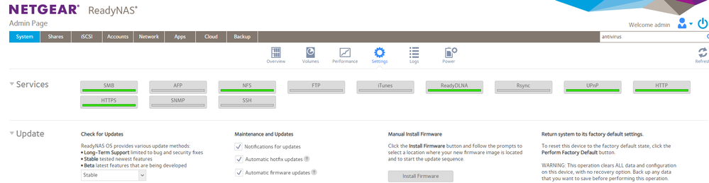

I have two ReadyNas devices. Both have firmware 6.10.4 installed. One ReadyNas 104 (NAS_2) works perfectly, but does not have the Antivirus button in my settings, nor the file share one. (See below)

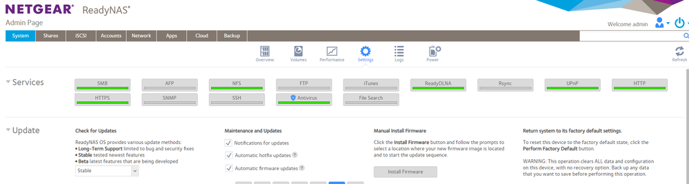

The other NAS ReadyNas 212 (NAS_1) has the Antivirus button, turned on, and the file share button, turned off.
This NAS (NAS_1) sends me daily emails saying:
"Antivirus scanner definition file update failed due to download failure. Check your Internet connection."
1) How do I enable the Antivirus button and file share button on the NAS (NAS_2) that does not have them please?

You'll need to live w/o antivirus on the RN104. It just doesn't have the resources to run it.
Some others here have also run into the AV update problem you are seeing on the RN212 - it was first reported last July. Netgear is aware of it, but for some reason has been very slow in resolving it. It is possible to update the AV manually if you are comfortable using SSH. There's a very long thread on the topic here: https://community.netgear.com/t5/New-ReadyNAS-Users-General/RN214-Failing-to-Update-Antivirus/td-p/1949771

- plemansGuru - Experienced UserMy understanding was antivirus was removed in after version 6.10.0 of the firmware for the RN104
https://kb.netgear.com/000060716/ReadyNAS-OS-6-Software-Version-6-10-0- RacingTogAspirant
