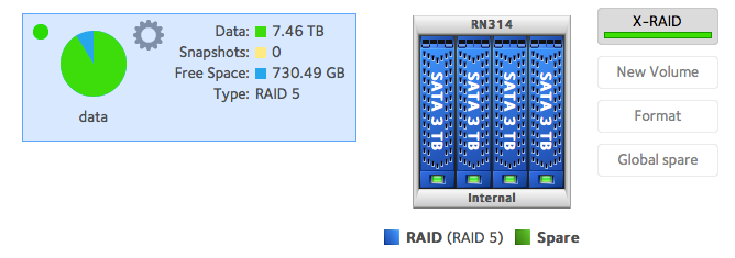

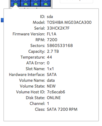

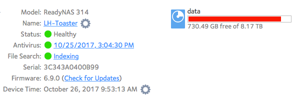

I am about to upgrade my RN314.  It came with 4 3TB drives and is getting full. I have searched around on the Netgear support and this community and did not see any clear instructions so I wanted to post my plan here in hopes that a wiser person will say its good or that I am missing something important.
Here are a few screen shots of the current status:

    The process will work, though it will need to do a full resync after each drive insertion.  The resync time will grow as the volume increases.
    Capacity will begin to increase when you upgrade the second drive (growing 3 TB per disk at that point).  You likely will need to reboot after the second resync completes in order to trigger the vertical expansion.  After that, you shouldn't need to reboot.
    If you can back up the NAS, you might instead do a factory reset with the new drives in place, reconfigure it, and then restore the data from backup.  The data will of course be temporarily unavailable, but the overall process will be quicker (avoiding the repeated resyncs).
