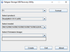

issue creating ReadyNAS 314 USB recovery tools (firmware ReadyNASOS-6.7.5-x86_64.img
Model:ReadyNAS 314
Firmware: 6.5.1
I tried all day to upgrade RN314 system's firmware to 6.7.5 because I no longer can access to the admin page (Netgear RAIDar reports "Management service is offl...

Why did you put the html file in there? That file is just the release notes and irrelevant for attemping USB Boot Recovery. Remember USB Boot Recovery wipes the internal flash and puts a copy of the firmware onto it (the firmware is the .img file). If this mismatches what's on the disks then the system will attempt to address this on the next normal boot.
Did you remember to run the tool as an Administrator (Right click on the exe and select Run as Administrator)?
