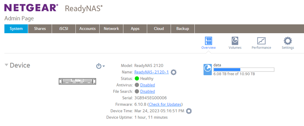

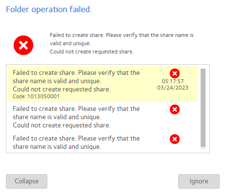

Unable to create shares - ReadyNas 2120, Firmware 6.10.8
My ReadyNas 2120 has been in use for several years and has been running fine. It has existing shares.
Recently I tried to add an additional share and it failed. See the error message below. It's grousing about the share name. No name that I enter works.
A reboot of the storage device did not clear the issue. Any idea about what's going on?
    Did you download the log zip file, and look there for clues?
  • The log files indicate that the file system has become Read-Only. I'm not sure how this occurred. Any suggestions regarding how to get around this and restore R/W access?
    Mar 24 17:03:14 ReadyNAS-2120-1 readynasd[2428]: Error: Fail on '/data/Test' [ERROR: cannot create subvolume: Read-only file system
    Mar 24 17:03:14 ReadyNAS-2120-1 readynasd[2428]: Create subvolume '/data/Test'
    Mar 24 17:03:14 ReadyNAS-2120-1 readynasd[2428]: ]
    Mar 24 17:03:14 ReadyNAS-2120-1 readynasd[2428]: pre_proc_add_shares() failed with status=1
    Mar 24 17:03:14 ReadyNAS-2120-1 readynasd[2428]: Share Test creation failed.
    Mar 24 17:03:15 ReadyNAS-2120-1 readynasd[2428]: NAS_SEND_MSMTP_RUN: Fail. (status=69. error_buf=(null))
