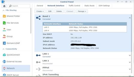

I have a synology with 4 ports and a RN312 with 2 ports. Can I connect 2 ethernet cables directly between these 2 NAS' to speed up file transers to 2Gbps?
I bonded ports 3 & 4 in the Synology....

What you need to do here is connect both NAS to a smart (or managed) switch, and then aggregate the links. Also connect that switch to your main network. A GS108Tv2 is one of several Netgear switches that you could use. These switches have their own Web UI, and you use that to configure the link aggregation on the switch (coordinating that with the NAS configuration).
As far as the bonding options go, you'd want to use either Round Robin in the ReadyNAS (with a static lag configuration in the switch), or LACP in both the ReadyNAS and the switch. I don't know what the aggregation modes are called in the Synology. If your goal is to speed up NAS->NAS backups, the static lag is better. LACP is designed to limit each data flow to 1 gigabit, so it won't improve the performance.
However, my advice is not to bother with any of this. If you have a lot of simultaneous users accessing the NAS, then link aggregation to the NAS can improve throughput. But home NAS users generally don't have much simultaneous access. And incremental backup speeds will be fast even over a single ethernet connection - likely less than half an hour to back up the Synology. So there isn't a lot of gain for most home NAS owners - not worth the hassle.
