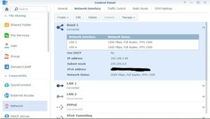

link aggregation between two NAS'?
I have a synology with 4 ports and a RN312 with 2 ports. Can I connect 2 ethernet cables directly between these 2 NAS' to speed up file transers to 2Gbps?
I bonded ports 3 & 4 in the Synology....
