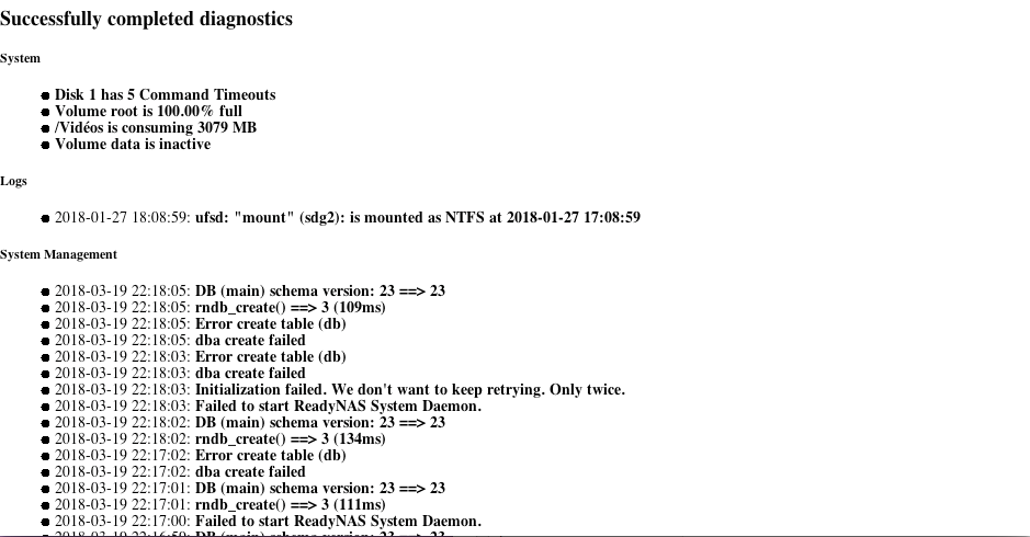

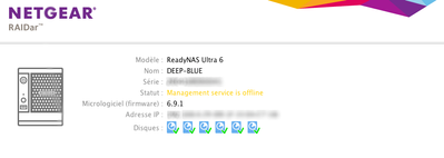

Since a few hours my readynas (Ultra 6) LCD screen shows "Retry Startup". After a few unsuccessfully access to the admin page & reboot attempts, I checked RAIdar (6.3-T1) that confirmed Management service was offline.
A look at RAIDar diagnostics confirms root volume is full :
 Unfortunatelly:
1. SSH access is not possible (I've seen it helps in many cases...)
2. Boot menu options are not available (LCD Screen stays stuck on Boot menu, backup button not responding, impossible to reach OS Reinstall)

  • Solved thanks to mdgm :
    1. OS Reinstall finally gave me access to the management service
    2. After SSH activation I found and deleted the big file that was filling the root volume :
    # mount --bind / /mnt
    # du -csh /mnt/*
    Thanks mdgm for your time and the few tips.
