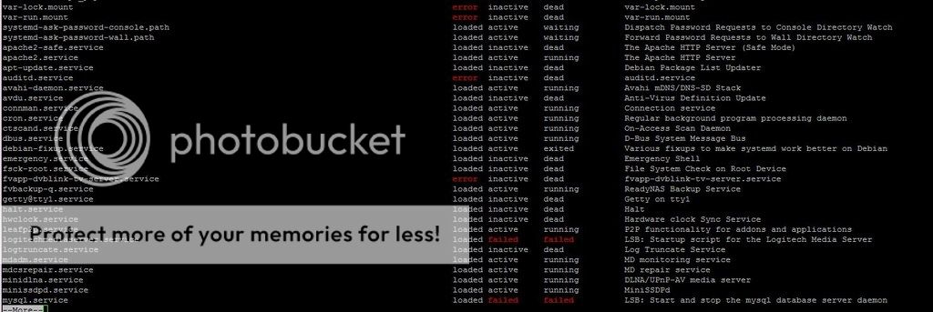

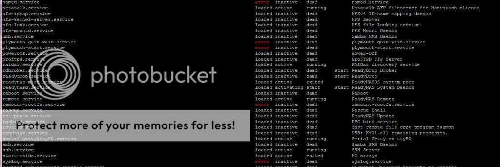

Here are some services that aren't running, for whatever reasons:
http://i1346.photobucket.com/albums/p699/Sledge1964/Failed03_zpsxzduhwmt.jpg
http://i1346.photobucket.com/albums/p699/Sledge1964/failed02_zpsrtvxgpgx.jpg
http://i1346.photobucket.com/albums/p699/Sledge1964/Failed04_zpsaoynnblh.jpg
http://i1346.photobucket.com/albums/p699/Sledge1964/failed_zpsa1ekzhtn.jpg

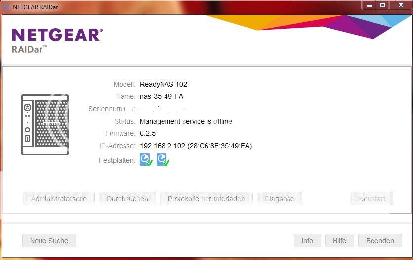

Raidar looks like this:
http://i1346.photobucket.com/albums/p699/Sledge1964/Raidar_zpswukna9g0.jpg

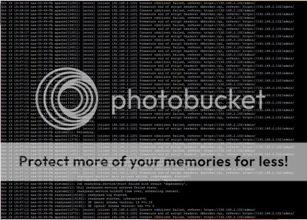

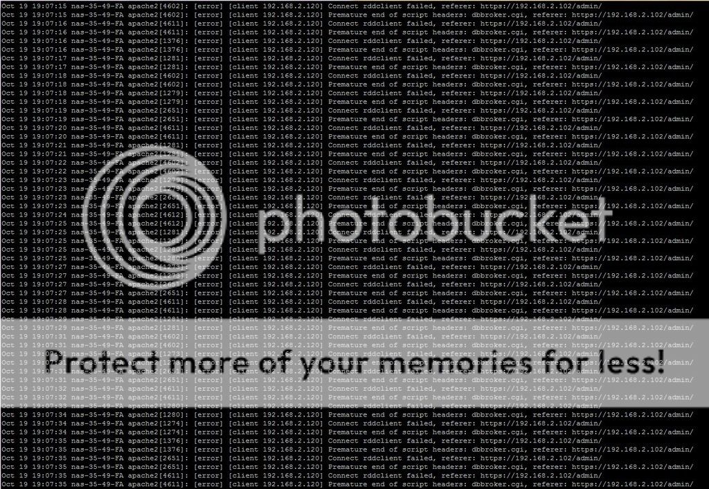

The journal is full of stuff like this, which repeats again and again:
http://i1346.photobucket.com/albums/p699/Sledge1964/journalctl01_zps4d74i5g2.jpg
http://i1346.photobucket.com/albums/p699/Sledge1964/journalctl02_zpsaiy8fd3n.jpg

      Those are the fails and errors I can see.  Raidar looks like this:
      Thats what the journal looks like - repeats and repeats etc
