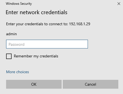

I tried the second command and the network drive was mapped successfully. The only problem is Windows keeps asking me to enter the NAS password every time I reboot the computer despite checking the option Remember my credentials. Is there a way to make this persistent?
Why does your method works but not when I used Map network drive in Windows Explorer? On my old computer, I mapped separate drive for each Share and Windows never asks me to login once. Each Share is set up for anonymous access.

The name of the Windows account where it login to the NAS is not exactly David. The weird thing is that the setup is exactly the same on two existing computers and there are no problems with them . I have also removed NAS account David from Shares permission, now all of them are Anonymous, except Home Folders which has Admin permission. See image.

I have removed NAS account David from Shares Permissions. All Shares have just Anonymous permission except for Home Folders which has Admin permission. I have removed the credential for 192.168.1.29 and left NAS-36-1C-14 in Credential Manager because I don't want the two to create conflict. I also re-entered the password for admin in the Credential Manager. Despite all these changes, Windows still prompts for admin password. Interestingly, even if I do not provide a password and hit Cancel, the network folders which I have mapped for the Shares are accessible, it is just the network drive \\NAS\Data that fails to connect. But if the NAS fails to connect, how come the Shares are accessible?

Interestingly, even if I do not provide a password and hit Cancel, the network folders which I have mapped for the Shares are accessible, it is just the network drive \\NAS\Data that fails to connect. But if the NAS fails to connect, how come the Shares are accessible?As I said before, you can only map the entire data volume if you use the NAS admin credentials. Also, it won't work if you are using the default admin password of "password". If you also have a data share on the data volume, it would be best to rename it - to avoid any ambiguity.
Anonymous access has obvious security risks, especially on a business network. Microsoft has tightened up policies for this access in Windows over the years, and that might be part of your issue.
Another aspect is that when you have no credentials for the NAS in the credential manager, then Windows will use your Windows Logon and password. If there is a username on the NAS that matches the Windows Logon with a different password, then (a) you won't get access (even if anonymous access is allowed) and (b) you will get a password prompt.
I recommend putting back the NAS credentials for both the IP address and the NAS name - using your NAS David account credentials. I guess you could also try setting up credentials with the username of "guest' and no password - that might also work.
