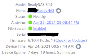

msg "Your ClamAV installation is OUTDATED!" is issued each time freshclam is run
High level details from my RN314 are below As you can see from the details above the AV is updating without issue since 6.10.4 Hotfix 1 was installed. However...
- Apr 26, 2021
Hi scrjs
The ClamAV version in the latest 6.10.4 firmware and the upcoming 6.10.5 firmware is 0.100.2. It works well in ReadyNAS device so far.
It is not recommaned to upgrade the ClamAV engine manually. ReadyNAS engineering team will be looking into the plan of upgrading it to the latest version in the future firmware release.
B_L
Apr 26, 2021NETGEAR Expert
Hi scrjs
- scrjsApr 26, 2021Apprentice
B_L wrote:Hi scrjs
Hi B_L ,
Sincerly thank you for the prompt response, I was wondering if this needed action on my part and you have clearly indicated that this will be resolved in future firmware updates for which I am more then happy to wait.
