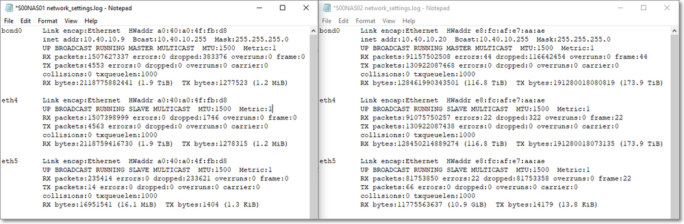

Network_settings.log are also a good place to look (errors, dropped, overruns, etc).
Do you have flow control enabled in the switches? That also could result in variable transfer rates.
Here is the network_settings.log (problematic NAS on the left):
Bond0 is the bonded adapter consisting of eth4 (set as Primary Device) and eth5. Those drops on the secondary interface (eth5) seemed odd to me. However, on my NAS not experiencing the issue there are similar drops (log on the right). Is that just the way the Active Backup mode deals with packets on the secondary inteface?
No. Flow Control is disabled globally on both switches, and the NAS that is not experiencing the issue is using these same 2 switches.
