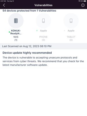

Nighthawk software reports vulnerabilities with ReadyNAS Firmware 6.10.9
My NETGEAR router has been reporting vulnerabilities with the latest firmware (6.10.9) as it can be seen from the following screen capture. Is NETGEAR going to do anything about it? I. Konuk ...

Thank you @schumaku and @StephenB.
I did have SMB and iTunes enabled for some reason. I disabled it. I will post the outcome.
No ports are forwarded.
Curious how one does use a NAS (and for what purpose) without the SMB protocol? Could be SMB 1.0 enabled as StephenB mentioned. The iTunes Service is not security relevant - very different from the default http access ...
