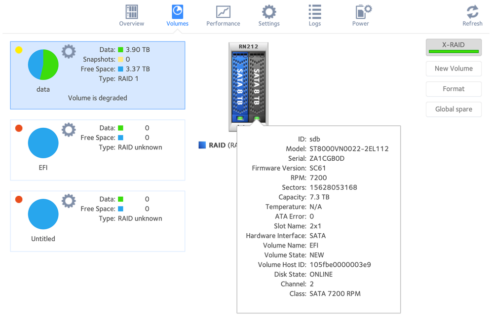

Hi,
After many years Drive 2 on my ReadyNAS Duo was starting to fail. So I hot swapped the drive, but it won't sync to the replacement drive. I have tried attaching the replacement drive to my mac via a SATA <->USB3 and it had no issue initializing, formatting and using it. The drive is identical to Drive 1.
As can be seen when I mouse over the replacement drive, it shows its capacity correctly of 7.3T (aka 8T) but it shows two? drives with zero free space on the left hand side of the screen.
I tried removing and putting the drive back in, as seen in the logs, but it doesn't want to sync.
Any ideas?

To fix the issue of formatting a drive with a "foreign" OS, I needed to 'Destroy" the drives that appeared, then remove and re-insert the drive. Now it is re-syncing.

Here is the screen shot I refer to in my post.

- StephenBGuru - Experienced User
Note that a "Duo" here means one of two specific models (the original Duo launched in 2008, or the Duo v2 launched in 2013). Calling your RN212 a "Duo" creates confusion.
Normally you don't insert formatted disks into an OS-6 NAS, instead you insert blank disks. What happens if you select the new drive in the center pane, and then click on "Format" on the right? EDIT: you did much the same thing by destroying the two volumes in the left pane.
FWIW, these aren't drives. The left side of the screen is showing volumes that the NAS is detecting. The two at the bottom are false detections - likely a result of the Mac formatting.
The "Format" on the right wasn't available. When I moved the cursor over it, the cursor didn't change like it did when I moved over the RAID button. I tried clicking on it but nothing happened. Though as mentioned I was able to destroy the two volumes, then remove and re-insert and it did start sync'ing.
dacarson wrote:but it shows two? drives with zero free space on the left hand side of the screen.
Thank you. I wasn't sure what they were as the Mac only showed one partition of the full disk space, but there were two listed. They also said they were zero size.
My RN212 has finished syncing and it is all up and running perfectly now.
