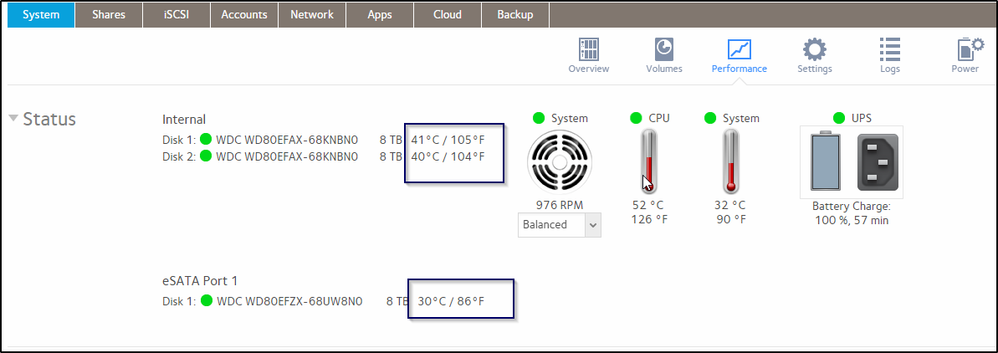

Hey guys,  WD says the normal operating temp is 0c-65c (for both models - I guess cooling is much better in the eda500).  Though I have been reading studies that say over 40c can shorten the lifespan.  The temp range in the pic is at idle, I did not test under load.  What do you think and what do you leave the fan settings on?  I would prefer not to use cool for energy savings.   thanks

    The EDA500 is certainly going to keep a single drive cooler.  Fill it up, and it will likely reach the same temperature range.  My drives usually run around 38C when mostly idle.
    Setting the fan to "cool" is going to have minimal effect on power usage.  It's the noise level that most worry about.  If that's not an issue for you, then set it to "cool".

    Blanker-2 wrote:
    ... I guess cooling is much better in the eda500 ...
    It's just that there is much less to cool.  Very little electronics other than the one disk.
    Impact of temperature on hard disk drive reliability in large datacenters (2011) found that 40-41c case temps increased the annual failure rate by about 6% - so there is an effect, but it is relatively slight for your temperatures. I haven't seen any information on how temperature might affect helium-filled drives.
    If that is worrisome, your options are to either move the NAS to a place where the ambient temperature is cooler, or switch the cooling mode from balanced to cool.  Maybe also see if it is positioned so it has good airflow around the fans.
    Enabling spindown might also be worth considering.  That should offset the energy costs of switching the fans to "cool".
