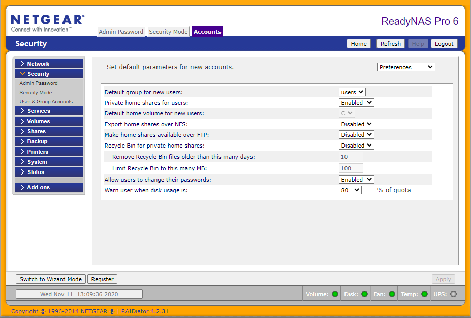

- DLinMANov 11, 2020Aspirant
Is this the only way to see if the Home folder is being used? How do I disable it? If I do disable it, she won't have access to that data. Would I have to copy over the 600GB of data into another share? Or, would there be a way to share that folder?
Navigate to security->User & Group accounts in the admin web ui. Then select "preferences" from the pulldown in the upper right. You'll see an option for "private home shares for users", that you can disable (second choice on the list).
